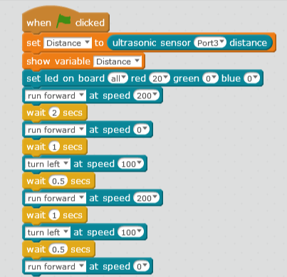

I feel kinda silly, but I do not know how to copy the scratch program. Should I just type it in?
When flag clicked
forever
set motor M1 speed 50
wait 1 second
set motor M1 speed 0
wait 1 second
etc.

BTW, that is just a screen capture of the code. I don’t know how to capture code longer than on screen length.
Does anybody know if you can print a long program to a printer or file?
#7
Nope, you have to do screenshots. Made life “interesting” when I was writing the eBook for the mBot.

#14
my program looks just like the one posted above.
#15
No it doesn’t. I don’t have the orange blocks. They are not available on Scratch for MBot.
