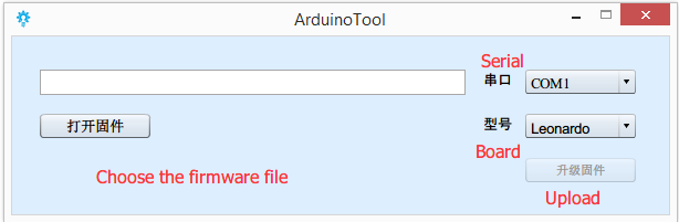

Btw the tool you linked was in ??CH?? Is there an English one?

Hi @nine,
We will translate that later. If you want to use it now, please follow the instruction below.

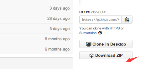

Hi @Emily_Kelton,
You need to download the firmware at first. https://github.com/Makeblock-official/Makeblock-Firmware
And use Arduino IDE to upload the firmware to your board.
