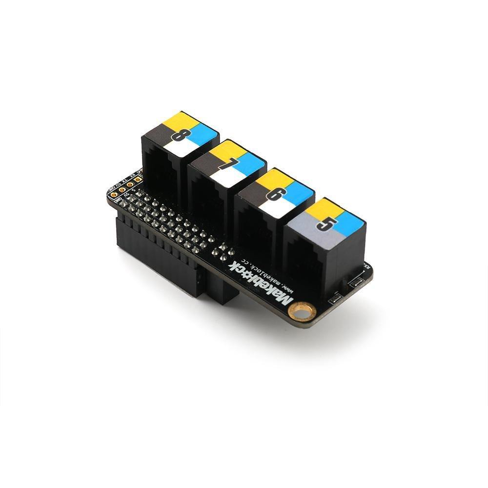

No, I have not. The sensor connect to board using an RJ25 cable, which MegaPi doesn’t have.
You can buy a shield for MegaPi that allows it to connect here:
#7
Thanks for your help. We have a shield like that and have managed to physically connect the Me Color Sensor V1 by RJ25 cable, but unfortunately it seems that the sensor is not compatible with the MegaPi board (only the MegaPi Pro).
