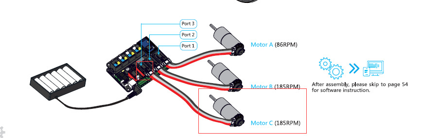

I have assembled the camera dolly using Ultimate 2.0 series. Motor attached to the front and back wheels seem to be working fine. But the 3rd motor 185 RPM which is suppose to be attached the camera stand just doesnt seem to be working, which restricts the rotation of the camera stand…what is it that im doing wrong or missing?

Hi 123,
Do you mean the motor C doesn’t work?
Please check if it works when connect to Port 2? Besides,change its wires with the wires which was between port 2 and Motor B have a check.
