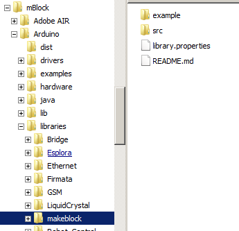

Thanks for the reply chuckmcknight. I had already seen this post and put the libraries in
I also downloaded Arduino and tried the test programs. One of the motor ones works but I can’t get any of the others to work.
Just read the first link again I think I put the files in the wrong place. Will try the bot tomorrow.
Joe
#12
Moved the files and it now responds to the remote, whoopee. Bizzare reponses but it’s definite progress.
