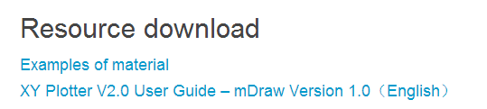

Hi,@bignic
We suggest that you use mDraw software to control XY, it is simpler than Gremote.
http://learn.makeblock.cc/xy2/
