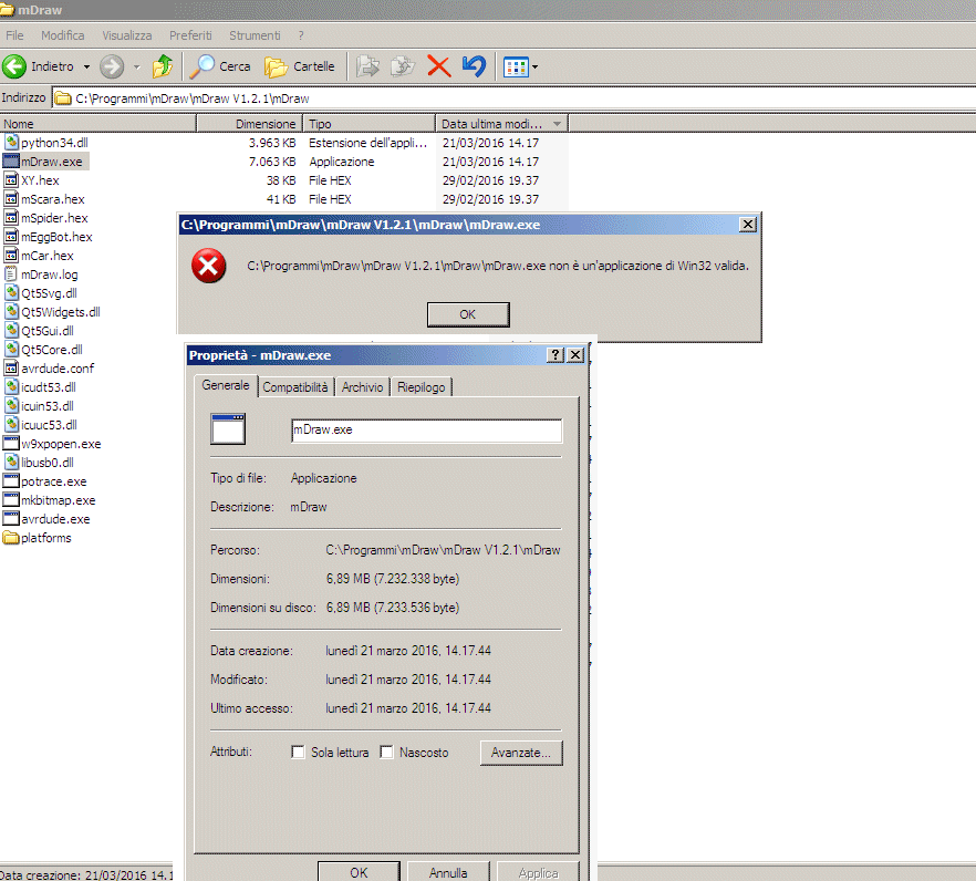

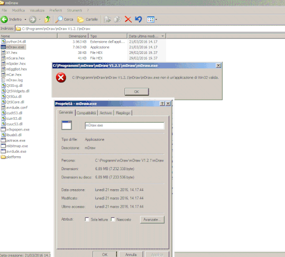

The mDraw.exe inside the “latest” gitHub zip file says “This is not a Windows 32 bit program” when I try to run it.

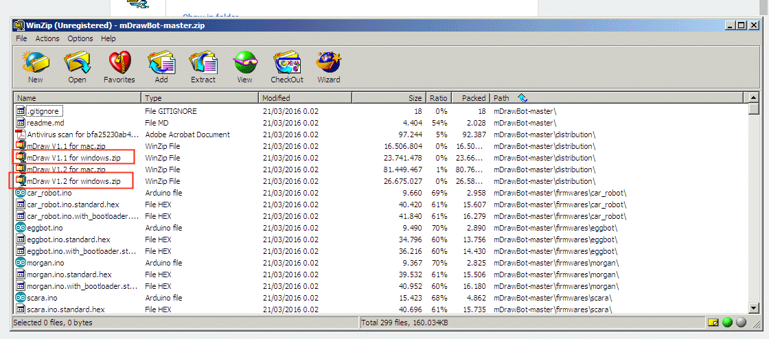

Have a look inside the “dist” folder within the unpacked strcuture, which should contain OS-specific folders for Mac and Windows, giving the exes.

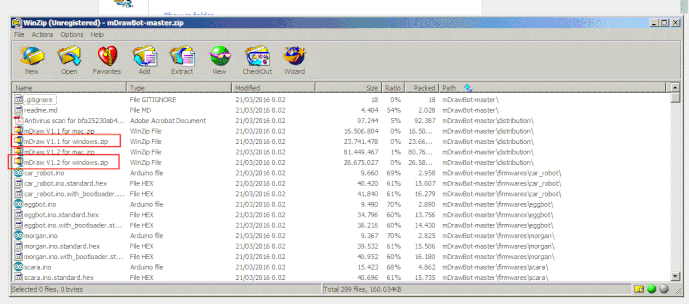

#3
Here are images which show the zip file contents and the exe I tried to get to work. Does yours have a different size/date/something?
#4
Ok, the answer is that the application in the github download is a Windows 64-bit build. I just tried it on my 64-bit machine where it ran fine, but on the XP machine I got the error message you got. Thinking about it, this was exactly the problem I first had with the older GRemote system, it shipped with a 64-bit executable. I’m afraid the fix for mDraw is a little bit more complicated than the fix I found for GRemote (which was to just dump the 64-bit java run time bundled up and use the pre-existing 32-bit java runtime on my machine).

#7
I’ve already posted this in the other hot topic but just in case you miss it,
In the latest mDraw, under Distributions folder, “mDraw V1.1 for Windows” works for 32-bit systems
