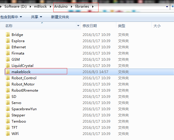

And you can download the makeblock library in this link: https://github.com/Makeblock-official/Makeblock-Libraries/archive/master.zip
Put it under the Arduino’s installation path and replace the previous makeblock file (if there is).

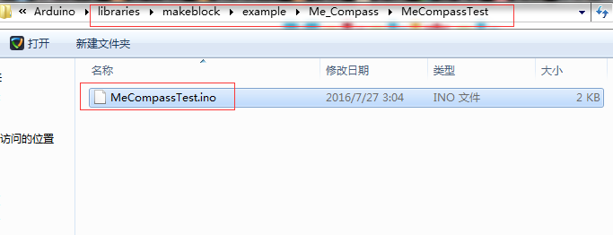

Then you can find the program for me compass under following path:
Open it with Arduino software and you can compile and download.
