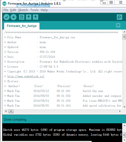

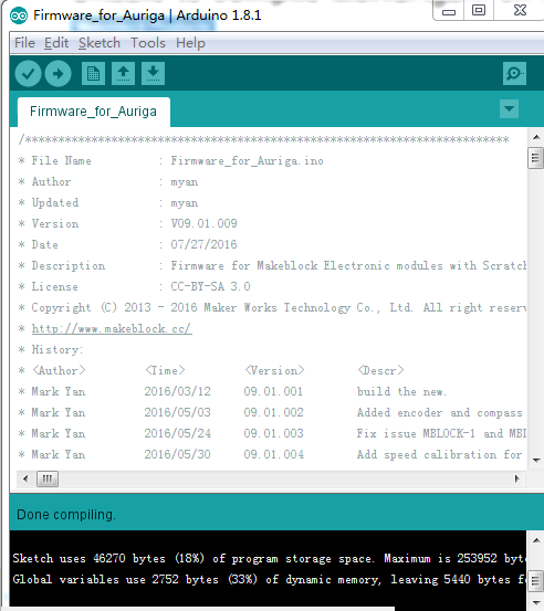

You may try compile the example program “Firmware for Me Auriga”:
Please make sure you have chosen the correct Board and Serial port on Arduino software refer to this link.
Once still the issue, you may update the makeblock library for the Arduino software on your PC.
