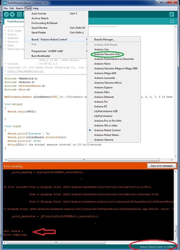

Actually, the compiler output is below the code window in Arduino, below is an example of what I wanted to see.
This program is from the examples, and appears to be the one you are using, but you maybe got a spell check or something on that typo.
Good catch on that typo @srothe , and the library thing. I’ve found most of those examples have the Makeblock library
which may be good on mBot but not Orion? Anyway, the program will compile with the libraries as written when the correct board is selected, so I wanted to be sure that is correct as well. (That doesn’t mean it will necessary run on Orion)
The program below compiles with the board selected as Arduino/Genuino Uno, but with the incorrect board selected, we have the Status 1 message.

Yes, this is an example of choosing the wrong board with the correct libraries, in case that is the issue. Choosing Arduino/Genuino Uno would be correct for these libraries.
