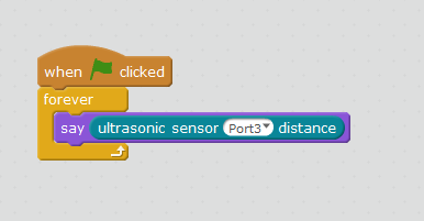

Please “Upgrade Firmware” for the main Board and then try the follow program to test the Ultrasonic module (here the Ultrasonic module is connected to Port 3 on the main Board)
Check if there are different value read from the Panda on the mBlock software. If it keeps saying 400, please try the following two points:
  1. Change the RJ25 cable between the Ultrasonic module and main Board.
  2. Connect the Ultrasonic module to Port 4 instead port 3, then modify the above program to Port 4 and see if there is valid data from Ultrasonic module.
