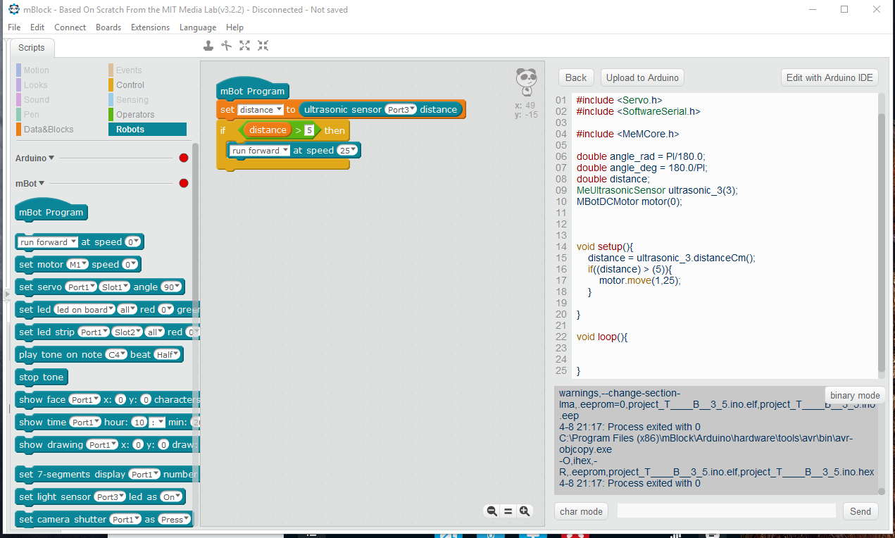

Hello,
i’m totally new in the robotic’s world, i have received my mBot today and after few try , i want to make my robot use his ultrasonic sensor. So i do this command (see image) and my robot just stay stuck , beeping like hell.
In my mind, this command should make him run forward until the distance detected is 5cm. What is wrong?

Hi Thralor,
Please try the following example program have a try (the mBot will not run if the speed set lower than 100):
