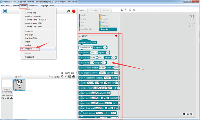

Hi QHuizer,
Which mBlock version do you use?
The mBlock 3.3.2 has integrated the program block for MegaPi board. You need choose MegaPi under Board:
#5
You sir, made my day! Was running 3.3.1, I installed the new version, updated the firmware and it works like a charm!
