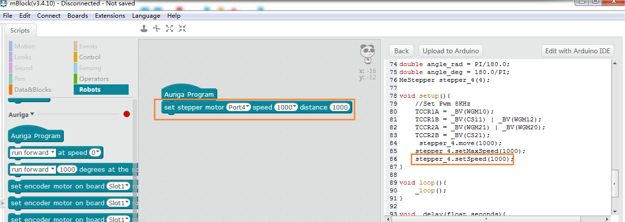

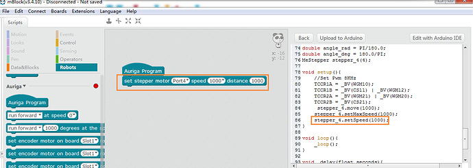

#2
You can test the following mBlock program have a check, if it works okay, I think there is problem on your program.
The Port 4 is RJ25 port (which is formed with several pins) on the Me Auriga, I think you can’t set a High or Low to a RJ25 port but to set a High or Low to a pin. For deep principle, you may need search online and figure out by yourself.
