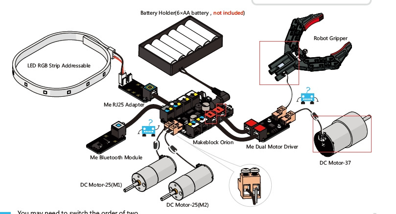

Program the arm, actually, you only need to program the 37 motor which control the arm and the motor in the Griper.
About programming with mBlock IDE for the 37 Motor and Griper, you can see the 37 motor is connected to Port 2 on Orion board and Gripper is connected to Port 1 on Orion board. Below is a example program.
