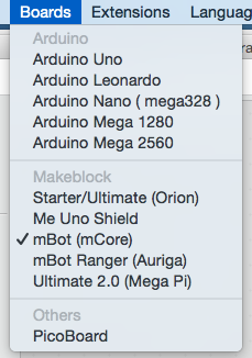

I am connecting my mbot via USB, selecting the USB port and I do have mCore selected as the board. Yet the “Reset Default Program” in mblock 3.4.2 quits saying “programmer not responding”. When I check the connection after it fails, I find that I am no longer connected to the mbot.

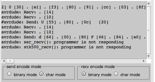

Upgrading firmware stopped at 24%. I then went into Arduino mode and I found the following:

Hi teacherz,
Was the bluetooth removed? Have you tried with other USB port and USB cable?
Besides, is it possible for you to try on another PC?
