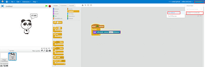

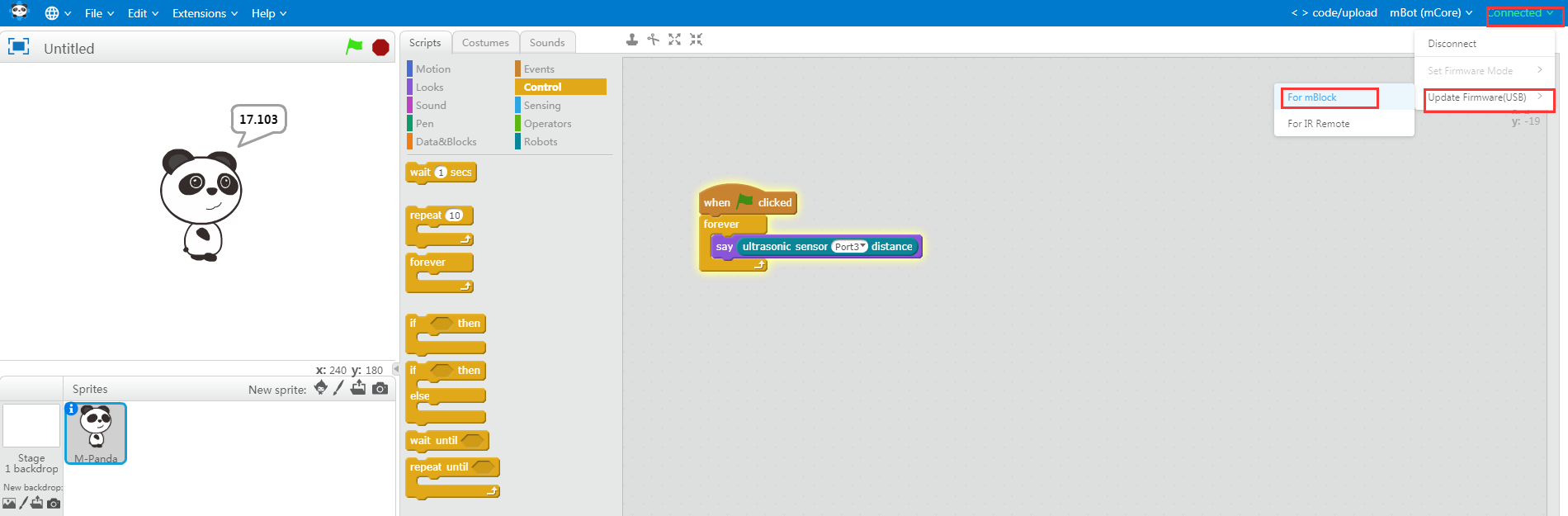

Hi bitabit,
Before running online program, we have to update firmware. In mBlock 4.0.4, go to connected>upgrade firmware >for mBlock
If your interface is not the same, please kindly show me a screen shot.

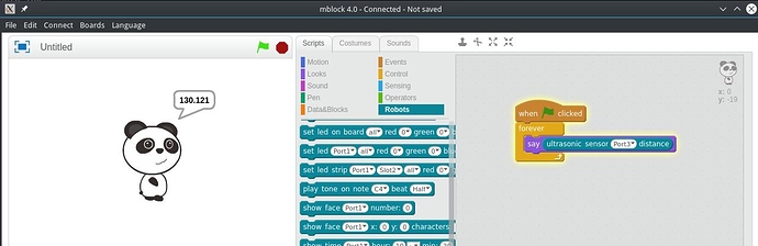

Thanks for the answer, but it doesn’t quite solve the issue that I have.
What I’m saying is:
  • Running Linux
  • Using mBlock 4.0.0 for Linux (I’ll try version 4.0.4 next)
  • Using the same code that you have on your screenshot.
    • Read sensor value
    • Display value on the Panda
When using the serial connection:
 It works.
When connected and using BlueTooth (My computer DOES have bluetooth, and DOES connect to mbot by Bluetoth) it doesn’t work. It always shows zero.

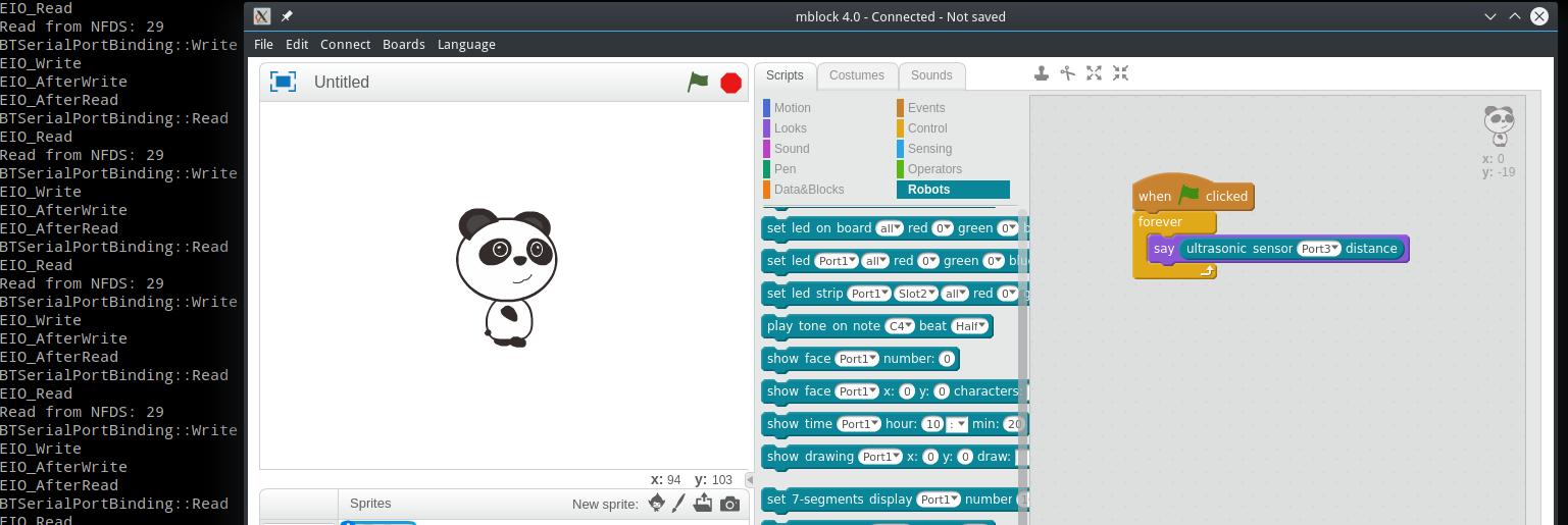

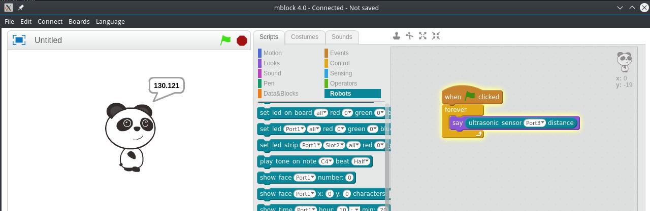

Ok, probably there is some issue communicating…
My computer does have Bluetooth so I do NOT need the Bluetooth dongle.
My computer with mBlock does communicate with mbot using bluetooth.
My computer running mBlock connected with bluetooth with mbot does execute programs.
Rephrasing: I can run scratch programs on mbot when connected to it by bluetooth.
I can do anything using bluetooth with mblock scratch except reading sensor values.
I can NOT read sensor values when using bluetooth.
I CAN read sensor values when using USB serial port.
I’ve already upgraded firmware -> Not solved.
I’ve reset the factory program -> Not solved.
I’ve used the latest mblock 4.0.4 version from github -> Not solved.
Using the android APP or connecting directly to bluetooth using the Nordic App I can read the values.
So the issue is on mBlock program.
I repeat: When connecting by USB cable, I can read the sensor values. When connecting by Bluetooth it does not work reading values.
When using the Serial connection:
When using the Bluetooth connection:
