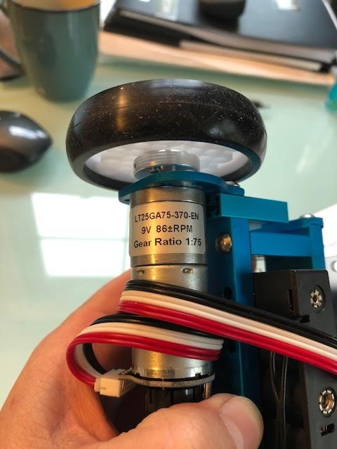

Very interesting. The ā€œSelf Balancing Robotā€ kit I received from The Robot Shop only had two motors. Both are 86 Rpm. On the motors it says:
LT25GA75-37-EN
9V-86+/-RPM
Gear Ratio 1:75
Sounds like the wrong motors were in the kit? Attached is the packing list for the Self-Balanacing Robot. Item 3 is two 86rpm motors. Is this correct or a problem?
I have tried wiring the motors both possible ways to the motor driver/encoder. The instructions show the wires crossing with the right motor connected to the left motor driver and the left motor connected to the right motor driver. The robot actually balances a little better when the wires are not crossed with the right motor is connected to the rightmotor driver and the left motor connected to the left motor driver. I sent some photos and videos to (stephanie.wu@makeblock.com) with https://transfer.pcloud.com/

What is the product code on the product that you received from robot shop?
RB-Mab-197 indicates •Optical Encoder Motor-25 6V/185RPMx2

Hi tweil,
To check this case, please help provide us with below info (to my email stephanie.wu@makeblock.com):
  1. where you purchased it? please offer the receipt.
  2. photo of your packing list if you can.
  3. photos of all of your motors in the package.
  4. photo of the bar code on the graphic carton.
  5. photo of the graphic carton.
  6. any damaged to the graphic carton when you first received it?
By the way, I haven’t received any picture or video from you.
