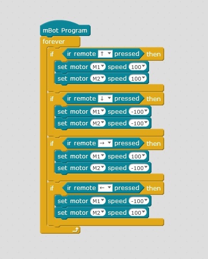

When I use the default program , the engines work perfectly.
When I use a program that controls the motors with the remote control then the motors do not work well
I use 4 new battery AA and the wheels are ok.
Can you help me?
Thank you.
Can you help me?
Thank you.

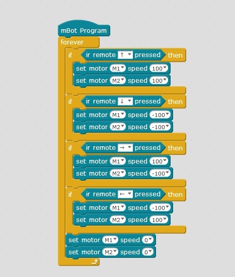

This lose power in motors
This is ok. (without the motors stop)
I also tried to replace the batteries , but nothing
Many thanks

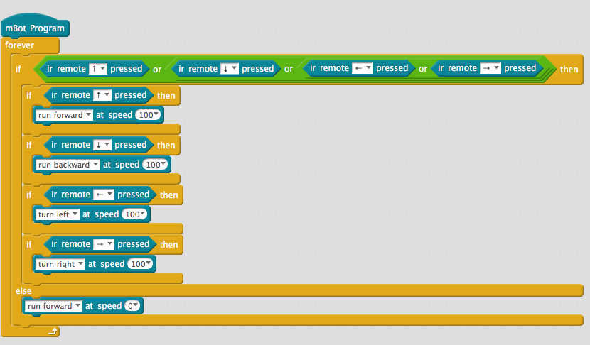

One of the things I found was that if I’m running the program remotely, I needed to use a filtering if-else statement. I’d also suggest using the [direction] at speed [speed] block as well because it is doing under the covers what you are doing manually.
