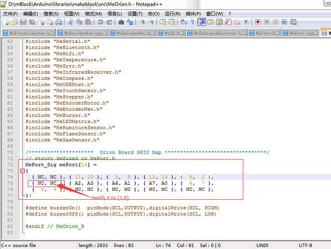

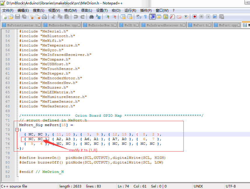

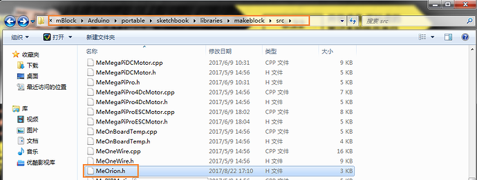

Hi mkmakeblock & mddickey,
In the new Makeblock library, we have fixed the Port 5 as serial port, it cannot be used as digital port.
If you want to use it as digital port, you can change the head file for the Orion.

Hi mkmakeblock
It still can be used as the Serial port after you changed the head file.
But it cannot be used as digital and serial port at the same time.
Duo to that there may be some conflict for USB connection when use port 5 as digital port.
If it is not necessary, we still suggest that fix the Port 5 as Serial port only and use other digital port for the 7 Segment LED.
