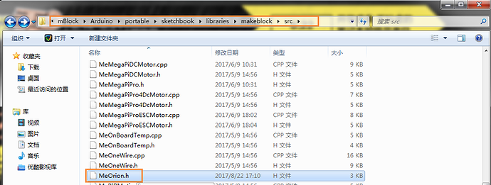

Hi Micc,
Do you use the mBlock integrated Arduino software 1.6.5?
If yes, you may try modify the .h file under this path too:
