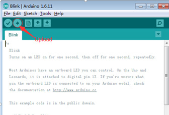

Hi, here is an instruction to test if the Orion board is defective.

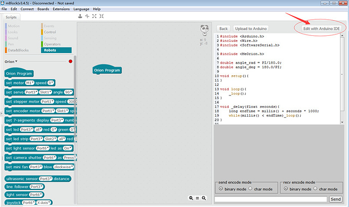

I. Please open the Arduino software through the mBlock software:

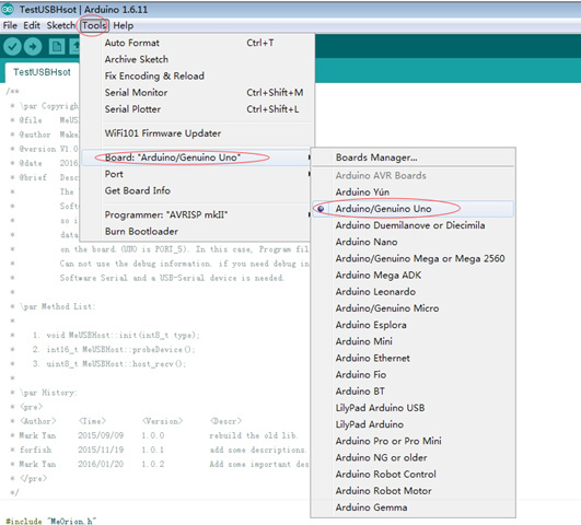

II. On Arduino software, go to Tools->Board and choose the correct Board type for your robot.
If it is mBot, Starter, Ultimate 1.0, XY Plotter, here you can choose the Arduino/Geuino Uno.

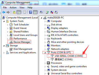

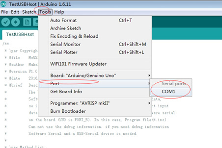

III. Go to Tools->Port, then choose the correct serial port for your robot. You can check your robot/main board serial port under your computer’s Device Manager->Ports (COM&LPT))

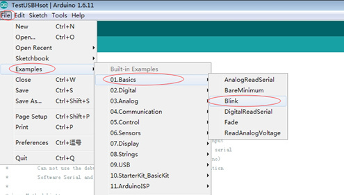

IV. Go to File->Examples, find and open the example program file “Blink”.
V. Upload the program to the Robot and see if it can be upload successfully.

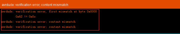

Result:
  1. If the program upload successfully. Please check if there is a LED keep blinking on the Main board. If there is a led blinking, it means the main board is working ok.
  2. If there is an error like below, it means the board has lost its bootloader. Normally you need a new board in this case.
