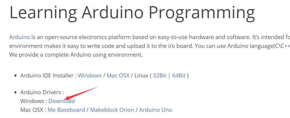

Have you installed the Arduino driver, if not, please download the driver (for windows) in this link and install it:
http://learn.makeblock.com/learning-arduino-programming/
After you installed the arduino driver, on the Arduino software, make sure you choose the correct Board (Arduino UNO) and correct Serial Port under Tools option.

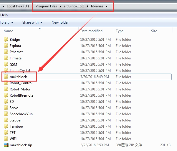

Please uninstall the Arduino 1.0.6 and download the latest Arduino software in this link: https://www.arduino.cc/download_handler.php?f=/arduino-1.6.8-windows.exe
After installed the latest Arduino, please download the latest makeblock libraries ,and replace the old one .
here is the link: https://codeload.github.com/Makeblock-official/Makeblock-Libraries/zip/master
Note: sometimes the Arduino driver will be uninstalled either when you uninstall the Arduino 1.0.6, so you may need reinstall the Driver.
