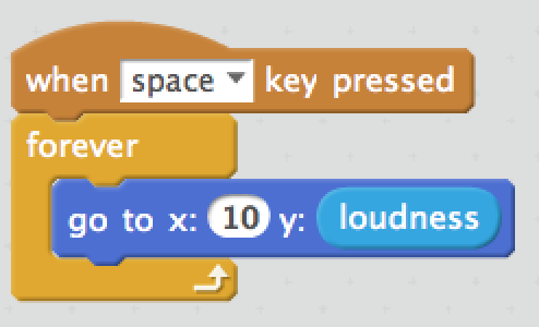

here is a tiny little program that moves the panda up and down depending on how loud the PC mic detects sound
The main issue I need to point out is that the microphone is on the PC and not the robot which means you can’t download this program to the robot. The other is obviously that the movement of the panda (sprite) isn’t something the robot is going to do either.
You could try to change the brightness of the onboard LED based on the reading from the microphone. All of this really requires you to adjust the raw output to match the levels you need depending on your output device.
I usually prototype it with some variable that I watch on mBlock to get a feel for the range of values.
