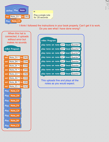

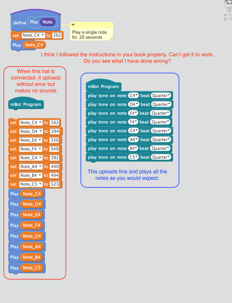

On the bigger attachment you will see the program as the book tells me to do it, I think I did everything correctly but it doesn’t work at all. I only use one hat block at a time, depending on which one I’m trying to load to the mBot. The blocks in the blue rectangle run perfectly. I am using mblock v3.4.11 on a Mac.

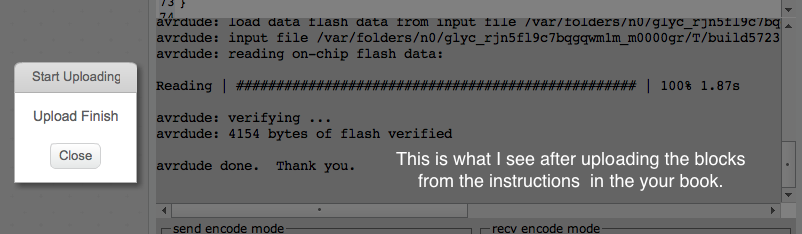

The smaller attachment shows what I get when unloading the blocks in the red rectangle when the hat block is attached to only those blocks.

Let’s examine your code more closely.
The Play [Note] function is the issue. What has occurred is that you have called the block being defined within itself which leads to recursion (i.e., the block calling itself). if you replace the call to Play [Note] with the play tone on note [Note] beat [Quarter], it should work as expected.
Don’t feel too bad because this is a common error that I’ve seen made by many of the students I’ve taught. :smiley:
The general notion of blocks is to encapsulate a set of functionality that gets reused rather than repeating the code every time it needs to get called. While it is certainly possible to call other blocks within a block, calling the block itself will result in unexpected behaviors (although recursion is certainly a useful technique in some instances).
