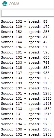

I would like to increase the value of speed every time sound sensor registers a loud noise (a clap).
The readings I get from MeSoundSensor are normally around 200-400. I use if statement. if > 500, then add speed. For some reason the speed is increasing always. Any ideas please?
The simplified code is below.:

The result I get:

First, you may not be aware of this but if you precede each line of code with four spaces, the listing will appear as below:

    if(mySound.strength() > 500);{   // second sound sensor read; semi-colon is ending the if test early
        speed = speed + 85;  // this always gets executed because the if test statement was short-circuited.
Your error is caused by the semi-colon in your if test. The semi-colon effectively ends the if test so you will always be adding 85. Below is a more idiomatic way of writing your code. :slight_smile:

Thank you for pointing out the error and for the good advice on the code!
Mattias
