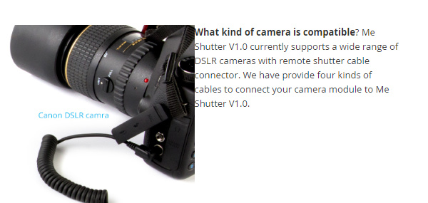

I am afraid the meshutter is not working with cellphones. To work with a DSLR camera, there should have some information for you: https://store.makeblock.com/me-shutter

It was mentioned in the post that you have provided 4 types of cables for different cameras. Are the cables included in the Ultimate 2.0 kits or shall I purchase them separately?
If I need to purchase, do you have stocks for these items?
Thanks
#4
It is not included in the Ultimate 2.0. You need to buy it separately according to your camera.
Meshuttermodule connector for the wire: 2.54mm breakout.
This is the wire what we have: http://learn.makeblock.com/en/shutter-cable-c1-c3-n1-n3-for-canon/
But I am afraid there is no available from Amazon, you can check with other distributor or buy a different brand.
