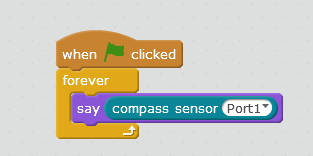

The Scratch program I attempted to use:
Control->When (green flag) clicked…
Control->Forever:
Looks->say [Robots->compass sensor (port 1)] for 1 secs

Please upgrade firmware for the mBot again to clear the uploaded default program on the main board.
Then you can test the online program with a green flag:
