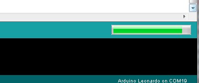

I have got a Starter Robot Kit V2.0 and managed to get it all put together. But When I try to upload the code to Me BaseBoard, there is an error message
" Couldn’t find a Leonardo on the selected port. Check that you have the correct port selected. If it is correct, try pressing the board’s reset button after initiating the upload."
( I press the reset button but it doesn’t seem to work). It will be appreciated if anyone can help me!

Hi NickPyner,
Leonardo did have this kind of problem. The correct solution is, you need to keep pressing the button until the progress bar arrive the right side.
Wish it would help you.
#3
Hi Johnny,
Thank for your help , I have solved the problem!
