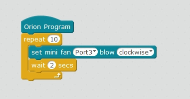

Hello KoFE,
Which board do you use to connect the motor?
Here attach a little example with makeblock orion board , hope will help, thanks!

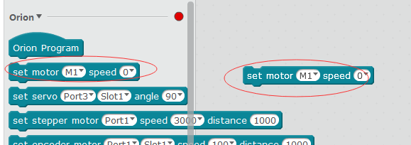

How to test motor port M1?
#4
Hi KoFE,
If you connect 130 DC motor to M1 port on Orion board, you can use this program block:
