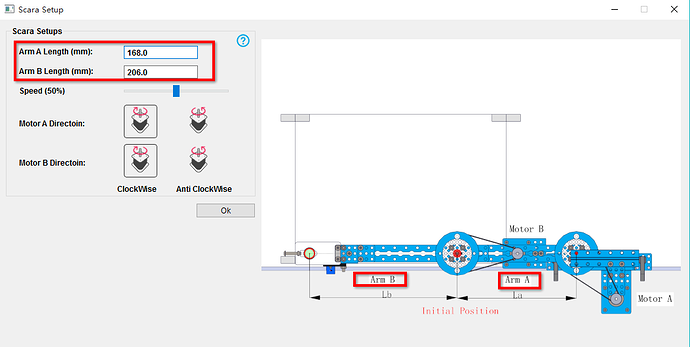

Is there any other software instead of mDraw for mScara? I tried everything, but mScara with laser is not engraving good enough like it is shown in Makeblock product page.

Hi Tobys:
the mScara issues may be caused by the incorret length of Arm A&B, as picture below. You could measure the length by hands to correct and try again
