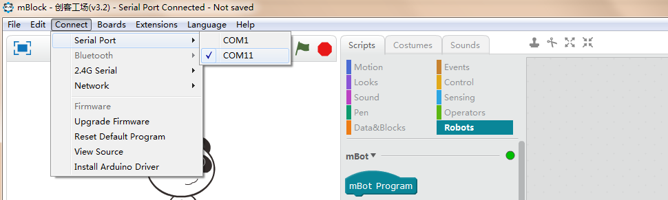

@jreile080506 Try the following steps:
install makeblock usb driver, see the post at http://forum.makeblock.cc/t/after-plugging-the-usb-cable-my-computer-cant-find-the-serial-port/1572
unplug battery pack, then connect mBot with computer via usb, turn on mBot.
open mBlock, choose Connect>Serial Port and select the port if your computer runs windows platform.
there is Reset Default Program option under Connect menu, click it to do a factory reset.
