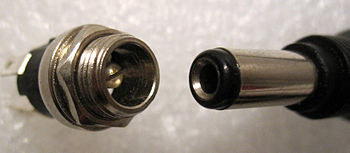

Hi,
What is the plug size of the mCore board?
I cannot find this info in the data sheet.
Thanks,
#2
I think it’s a 2.1mm plug. @tech_support, can you confirm?
#3
OD / ID is probably needed to identify it.
I cannot find this basic info anywhere on the makeblock web site…
#4
Hi chuck and bgolab,
The plug of mBot should be DC3.5 * 1.1. While other boards are DC5.5 * 2.1.
