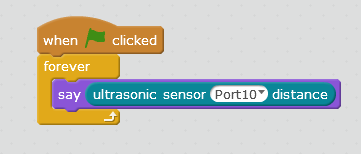

Besides, to test if the Sensor works normal, you can also test it through mBlock software:
Please note: you need upgrade firmware for Ranger first before testing above program.How to Upgrade Firmware for Ranger.zip (358.3 KB)
