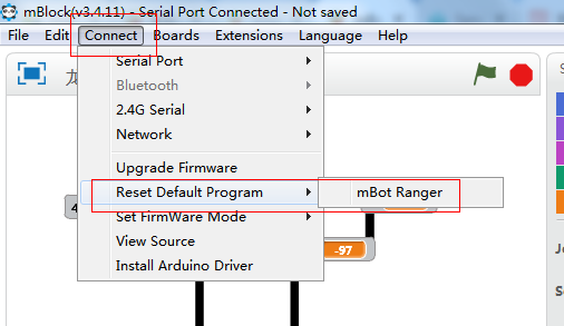

Here is the Makeblock software download link
You can download mBlock 3 for PC:
There are some guidance for using mBlock software.
To reset it, select reset default program under connect:

To use the Ranger, we can choose the original firmware or use our own program. Once we upload a customized program to the main board, surely it will wipe out the original firmware and only the uploaded program works.
To control it with mobile app, we need to reset it to original firmware with mBlock software.
