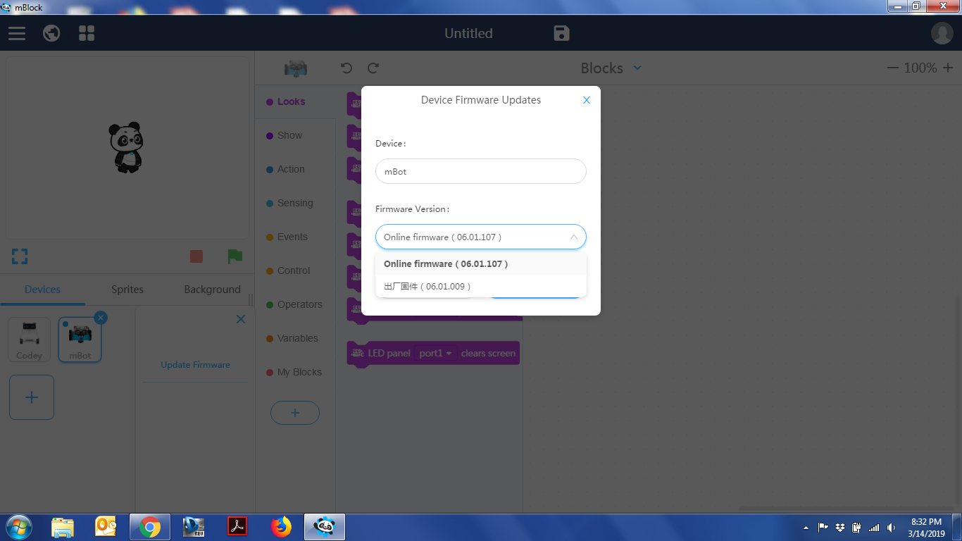

The firmware update screen on my version of MBlock does not look like your screenshot. I’m running 5.0.1. I tried to update MBlock, but it says it’s up to date. A screenshot of my firmware update screen is below. It gives me two options:
06.01.107 is the firmware I previously updated to.
06.01.009 is preceeded by Chinese (?) characters. I reverted to this version, but it did not fix the problem.
