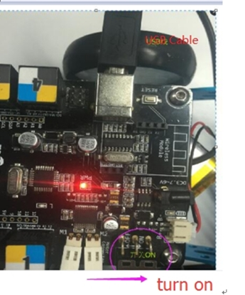

Step 2: Use the USB cable connect mBot to PC and turn on the mBot.

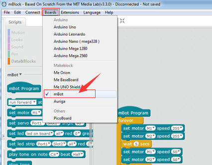

Step 3: Open mBlock v3.3.0, choose mBot under Board:

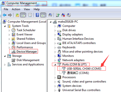

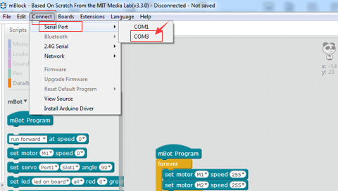

Step 4: Choose the correct Serial Port for mBot under Connect->Serial Port: (Here my mBot’s serial port is COM3, and you can check your mBot serial port under your computer’s Device Manager->Ports (COM&LPT))

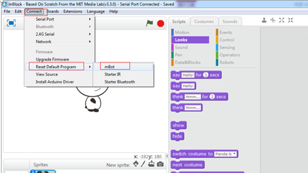

Step 5: Go to Connect->Reset Default Program->mBot, wait until it says Upload Finish.
