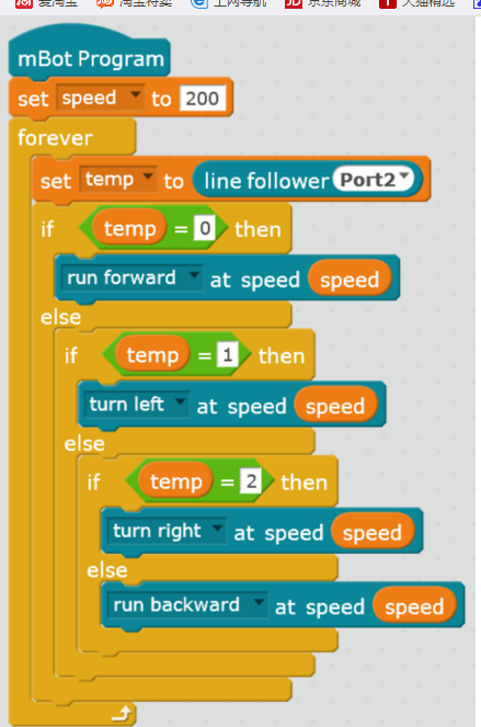

#4
Hi Ophitoxaemia,
The mBot doesn’t execute any uploaded programs or only doesn’t execute the program you pasted?
Will it work when upload simple program like below?
Have you moved the bluetooth module while upload program to mBot?
The mBlock provide graphical programming for mBot, you do not need to program it in C when program using mBlock.
#5
When I enter the Scratch code you posted, I get the following C code generated by mBlock:
