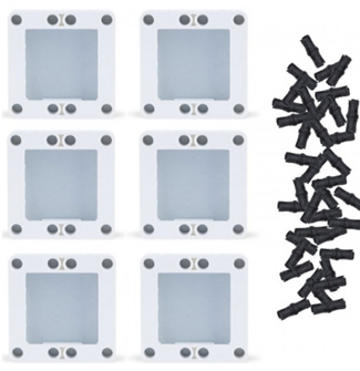

Are you talking about these metal boards ?
2018-12-19%2018_10_01-Window

I’m using a 400x400 mm metal white-board to assemble and program the blocks.
Very practical when you want to move the configuration from one place to another, especially with younger kids.
