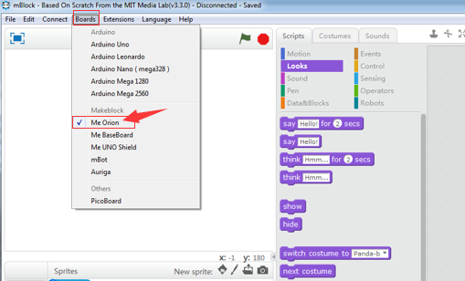

  3. Install the mBlock software and open it, then choose the Me Orion under Board:

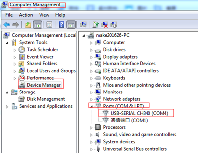

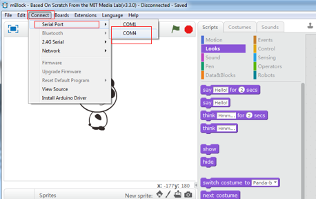

  4. Choose the correct Serial port of Starter Robot under Connect -> Serial Port: (Here my Starter Robot’s serial port is COM4, and you can check your Starter Robot serial port under your computer’s Device Manager->Ports (COM&LPT))

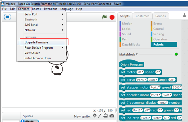

  5. Then choose the factory program for your device by going to Connect->Upgrade Firmware, then Close when it shows Upload Finish.
