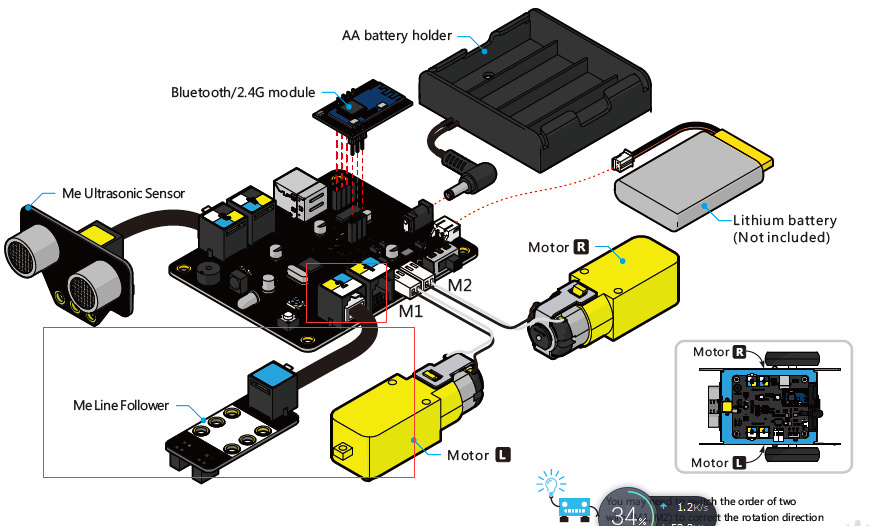

What port should the line following sensor be connected to, to use the line following mode in MakeBlock HD ?
#2
Hi Natsandwich,
Since the color ID on the Me line follower module is Blue, you can connect it to any RJ25 port with Blue ID, here is a link provide detailed info with Line follower module: http://learn.makeblock.com/en/me-line-follower/
When you program for the line follower module, need program with correct Port number.

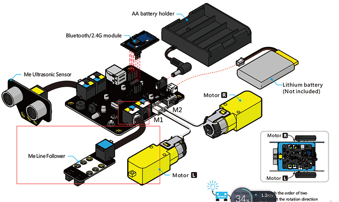

If you have a mBot, then the Line follower module should be connected to Port 2 with factory default program:
