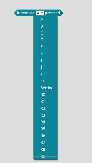

  2. how can the servo be controlled by the ir remote? Provided that I’ve completed the scratch on controlling the servo, I want to control it by the remote, how can I load my program to the mbot so that the servo can be used by pressing D and E in the remote?
Many thanks
qwert
#2
Hi qwert,
Actually, 3.7V lithium is enough for mBot. According to my experience, I think it is better than some 4AA batteries
To control the servo through IR, you can use following program block:

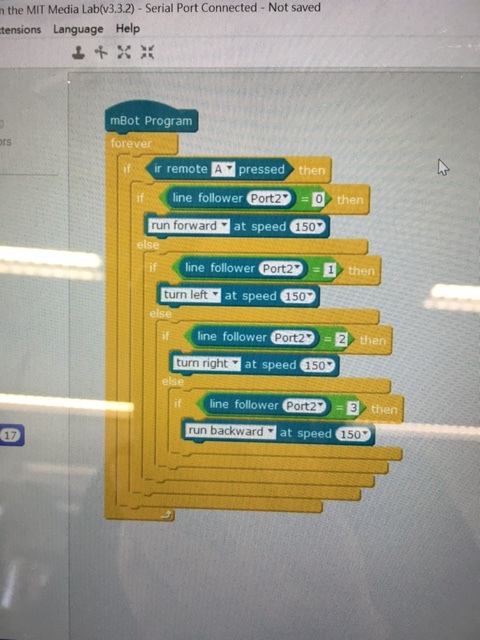

#3
Thank you very much for your reply.
I’ve encountered urgent problem. How can I make line following by use the IR remote? I can only do it by execution from the computer, but when I use the remote, I set “when A is pressed, then run the line following program”, it doesnt work at all. Would you please kindly advise ? Thank you.
qwert
#4
Hi qwert,
Could you paste your program here?
#5
#6
many thanks.
#7
actually without the line “if ir remote A is pressed then”, it can follow the line well.
but our task is to use ir remote to let it line following.

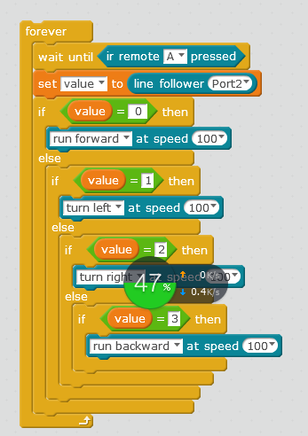

#8
Hi qwert,
You may need set a variable for the line follower. Please try the example program below:

#10
Hi qwert,
I have tested the program and it works properly.
You can add a mBot program head for above program and upload the program to the mBot, the you can test it refer to the program logic:
  1. Keep both the sensor1 and sensor 2 untouched to anything and press button A (value = 0), it will run forward.
  2. Keep touching the sensor 1 only with your finger (there is a blue led on beside the sensor 1), then press button A before you release your finger, (value=1), it will turn left.
  3. Keep touching the sensor 2 only with your finger (there is a blue led on beside the sensor 2), then press button A before you release your finger, (value=2), it will turn right.
  4. Keep touching the sensor 1 and sensor 2 with your finger (there are two blue leds on beside the sensor 1 and sensor 2), then press button A before you release your finger, (value=3), it will run backward.
