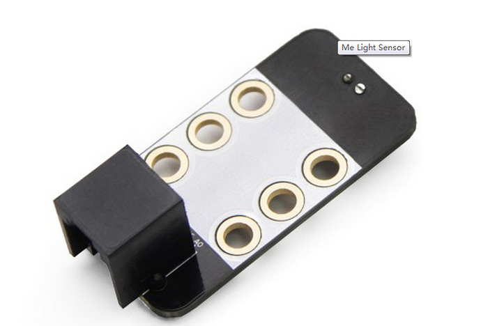

#5
I have the same problem. Connected a lightsensor to a MegaPi port but read one and the (somewhat) same value.
Would appreciate if someone from Makeblock would clear up this problem…
#include "MeMegaPi.h"
MeLightSensor lightSensor(PORT_5);
int value = lightSensor.read();
Serial.println(value);
#6
Hi Gino_talamini,
Do you use this light sensor shows below:
From the picture, you can see it has black RJ25 interface,so you can only connect it to Port 6, 7 or 8 on MegaPi.
From the picture, you connect it to Port 5.
#7
Aaaarghhhh. Stupid of me. You are completely right!
I changed to another port and now it works as expected!
Thanks for the wake-up call. :wink:
Kind regards,
Gino
