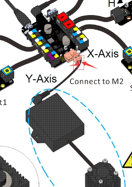

Hi Gundelputz
Please exchange the two small wires (which coming from the black box of the laser) from the yellow connection interface which marked on below picture.
