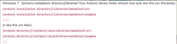

  1. Install the Arduino and Makeblock library referring from here: http://learn.makeblock.cc/learning-Arduino/ Please do take care of the install location as below:
