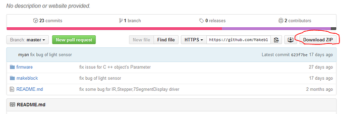

1 download makeblock libraries from https://github.com/Makeblock-official/Makeblock-Libraries and follow the README instruction to put the file into Arduino libraries file(suppose you have Arduino IDE installed).

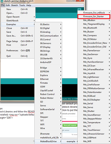

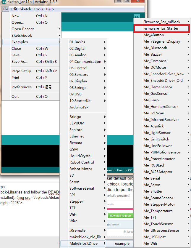

2 Open Arduino IDE, select example>MakeBlockDrive>example>Firmware for Starter.

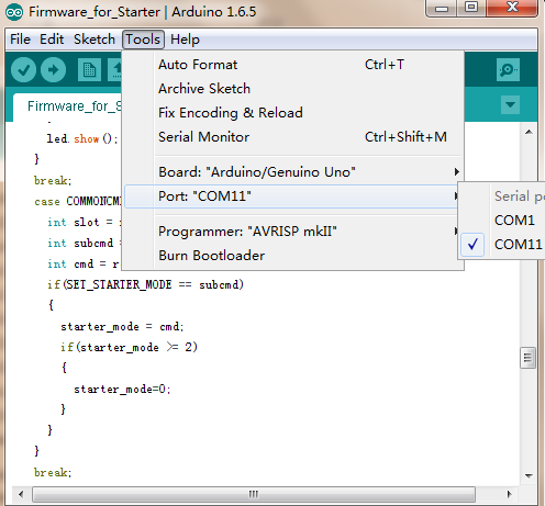

3 Connect Starter with computer via USB, select Tools>Board:Arduino/Genuino Uno and Tools>Port>Com x(select the port of USB in windows, in my case, the port is com 11). Upload program to Starter, then you are able to control Starter with IR remote controller.
