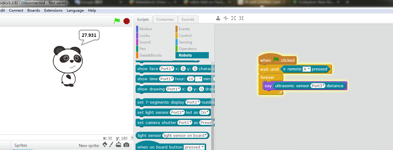

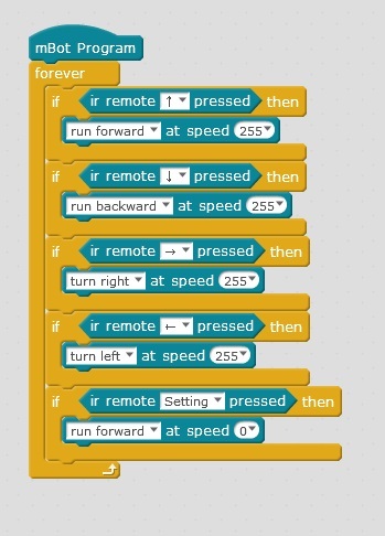

I uploaded simple program via USB cable which mbot controled with arrows on remote controller. And then changed the connection into WiFi 2.4G mode to get value from the ultra-sonic sensor which can mark in my mblock screen. The initial purpose was getting distance value of every obstacle along with my controlling mbot here and there.
I think those 2 modes get the signal into different channels (IR receiver and WiFi 2.4 dongle) so it has to work!
Thanks!
Jinu

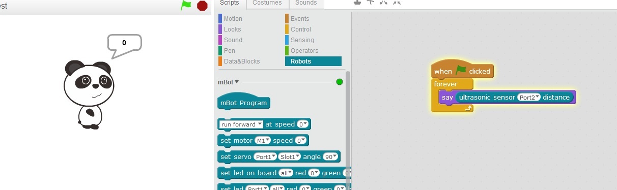

However, It is slightly different with what I am showing in the below. Please check if it even works in your side. I uploaded first motor control program via USB like first picture, and changed connection into 2.4G. In the last, I executed the program in second picture. And it did not show any acceptable value except “0”.
#4
Hi Notego,
You can not use it like this way.
Since you already download the first program into the mBot, the mBot can work with the program offline since the program already uploaded into the main board.
While the second program is an online testing program, it is impossible to work with the first offline program.
Besides, every time you start a online testing program after uploaded a program into the robot, you need Upgrade firmware for the mBot to clear the uploaded program, otherwise, the online test program won’t work wither.

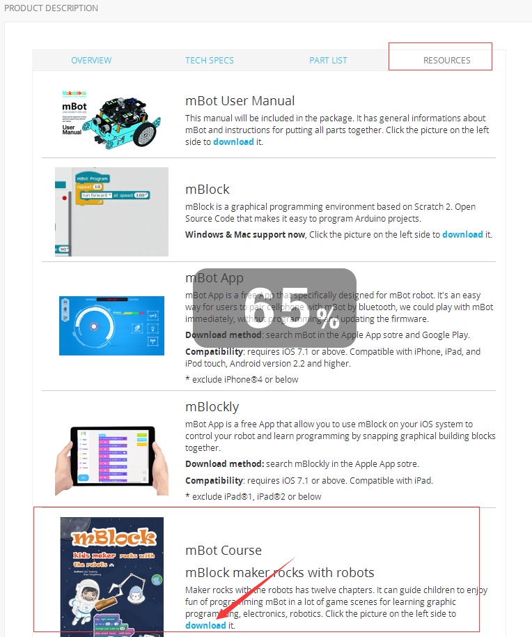

Here is a link where you can download the Document to teach you program on mBlock software, you may download it here and I think you can know better for programming the makeblock robot with mBlock:http://www.makeblock.com/mbot-v1-1-stem-educational-robot-kit
