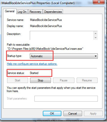

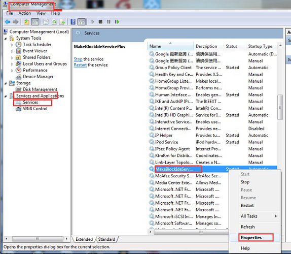

For this issue, please check the settings under the service have a try. Refer to the pictures below to find the MakeBlockIdeServicePlus, make sure the service status is started and the Startup Type is Automatic.

Ups, I could not find the entry MakeBlockIdeServicePlus, I could not find any entry with MakeBlock. But today I was lucky and both were connected in one go, without any installation. I have no idea what went wrong. Will see what will happen tomorrow.
By the way: My computer is all in German, but the entry has to be something with MakeBlock anyway ??? I made an export of the list and seached for “makeblock” without any finds…

Hi mgbig,
Yes, normally it has to be something wiht Makeblock. Maybe the settings on your computer is different if you can’t find it.
Since it works today, please temporarily ignore this settings and keep checking tomorrow.
