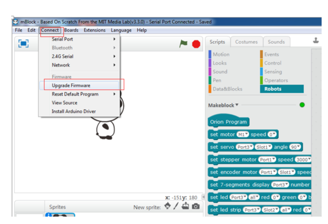

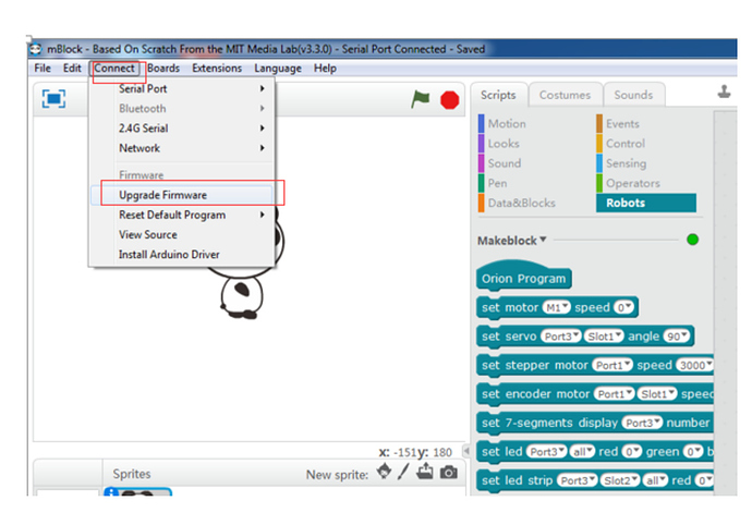

Sorry @tech_support if it’s unclear. I saw somewhere (image below) that there is a difference in previous version between Upgrade firmware and Reset default program. In mblock5 I only have one option: upgrade firmware.

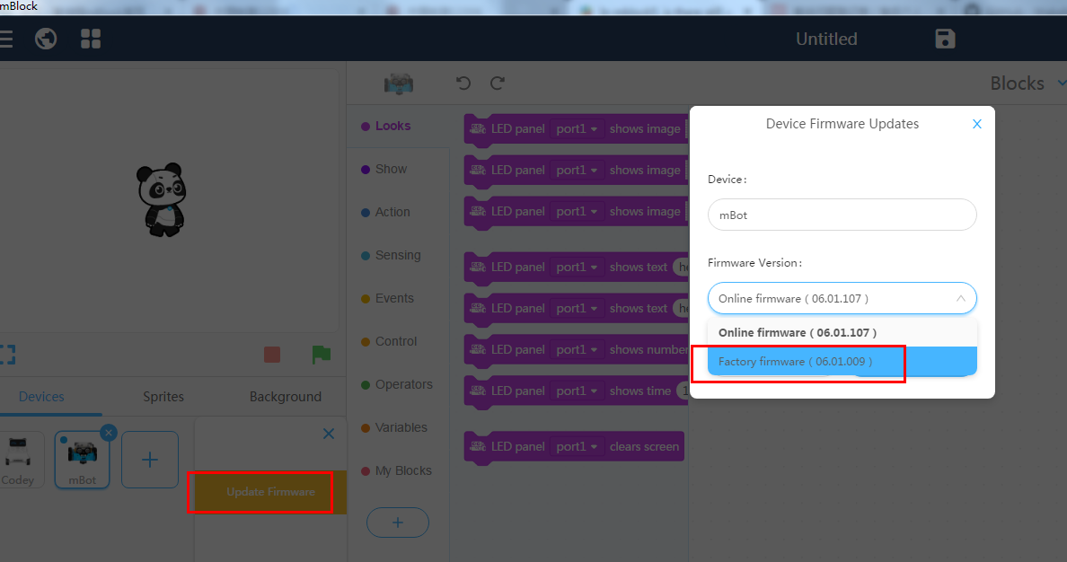

Sorry, my bad. Though mblock 5, go to update firmware, then we can choose default program, like below:
