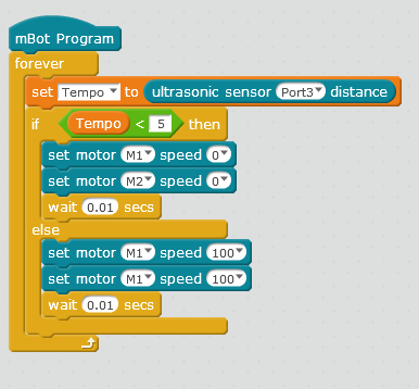

I am trying program the robot like this:
go forward if see any object 5cm stop so i want it to stop when it sees an object i want the distence to be 5cm

Hi ahmet,
Follow is an example, you can the mBlock program yourself through different ways:
